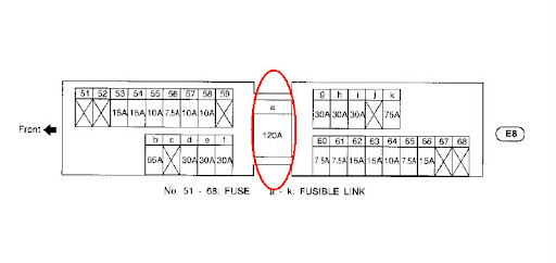

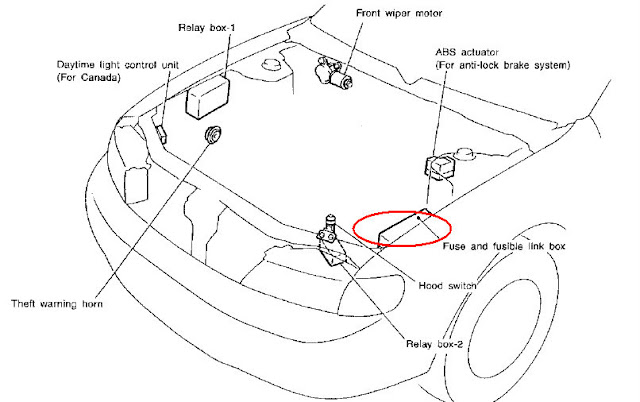

I managed to short something out while replacing my AC compressor. My windows,horn,tail lights,wipers, and sun roof are inoperable now. I assume this is a breaker. Does anyone know which one it is? Any help would be appreciated.

It sounds like you shorted the battery lead connected to the threaded rod on the alternator. Below are a few images of the first thing I would check as this is the primary circuit protection device for the terminal most likely to be shorted during this repair (I know from experience)
Next time disconnect the battery and you will not have this issue although you will have to reset your radio presets.
