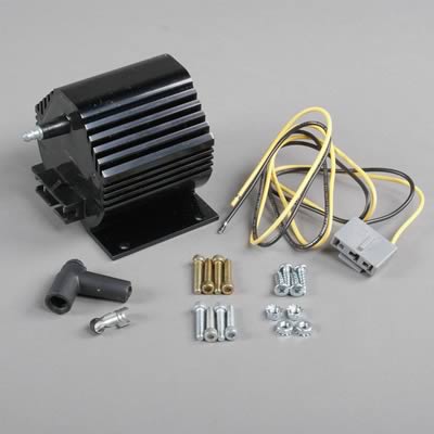

IF you want a strong setup we ran 6 MSD SS blaster coils on my friends 400 whp RB and the spark output puts any of the factory or aftermarket replacments to shame and cost about the same..
How to....
take your coils out and pull out the coil harness where its easy to see.
Mark each of the center wires they should be some combination of red/xxxx another color. Number them so you will remember what cylinder they fire.
Start at the ignitor and de loom the harness towards the coils. You will have 3 wires to each coil. 1 power, 1 constant ground, and 1 switch ground from the Ignitor.
The factory ground going to each coil will not be used.
Take the factory power and either daisy chain it across all the MSD coils or use it as a switch 12v for a thicker Relayed system.
Recommended
We used 10 gauge wire and a high amp replay since the factory wire is thinner gauge. You can use the factory power wire to switch your relay.
Now run your power, daisy chaining it off every coil to (+) side on the coil.
Now for the switch. Youll need to extend all the wires coming from the ignitor. The ignitor is a large relay essentially and it sends ground pulse.
Run a lead to each coil in the order you marked before removing the harness.
This goes to the (-) negative side of the coil.
Then use the boot kit they come with and make your wires and mount the coils somewhere and fire it up.

Quote, originally posted by Blown240sx »
How to....
Recommended
Yes, I own that car now, and have no problems w/ it whatsoever...if you need me to help out anyway with getting this setup to work for you, let me know...i'll help where I can
edit...didn't see the pictures, but thats my engine bay in the pics he posted lol

I really like that MSD setup, Thats Clean!!
My only question is on a SII we don't have ignitors. Is this a problem running that setup?

The S2 should work the same. Since they still send a signal directly to each coil. It should work the same. All ignition systems like this are switch ground.

good clean setup blown240, and i agree you'll end up spending as much or more with the stock style coils than the msd setup with 8mm that can be achieved for around $350 from summit, and if you need more spark due to higher compression $400 buys you higher output coils and 10 mm wires,
the summit (sum-850500m) coils are rated at 51,000v and have enough power to fire the discovery space shuttle to the next galaxy, there $50 a piece at summit, $75-100 for a good set of wires and your set, and you would go about hooking up that setup the same way as the msd, negative being the trigger, which comes from the harness that your stock setup uses

Quote, originally posted by crccustoms »
I cant take much credit since the previous owner (brandon) did the wiring but I fully understand how it was done and how it works.
