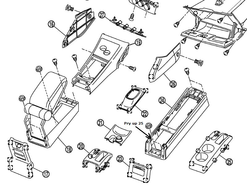

Have any of you ordered and installed this? How dificult? Any Pics of it installed in a Versa S? some info would be cool before I place my order.

I did. Very easy install, 10 minutes if you are slow & careful. You just pry the rear cup holder up from the side & remove. Then pull up the piece with the power socket, then the piece around the shifter. 2 torx screws in front, 2 nuts in back. Remove original console, then put in new console & reverse above instructions.
To see what it looks like, just look at interior of any SL Versa.
http://www.nissanusa.com/versa...0046; then click on Photos & Colors, then interior.

can u just swap out the part with the cup holders with the part with the arm rest??? why do u need to change the whole thing???

No. The cup holders is one piece that has the slot for the parking brake. Also different back cover. If you just swapped the piece with the armrest, you'd have a big hole around the ebrake and the back part wouldn't look right.
Parts 19, 21, 22 are common
S Console has 23, 24, 25
SL Console has 17, 18, 20
