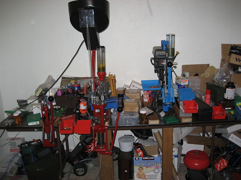

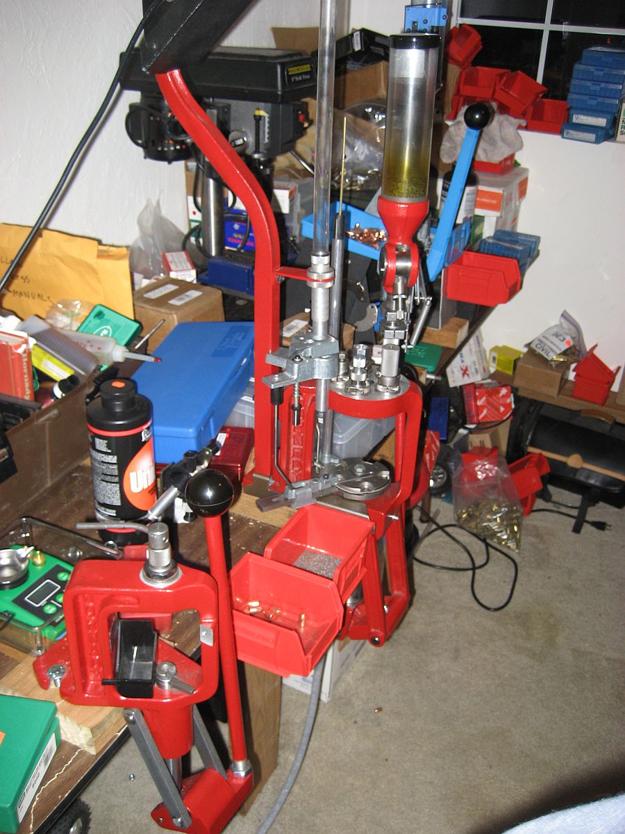

I'm not sure if you would call me hard core, but this is my reloading room:
Yeah, I know its really really disorganized but i know where everything is.
I reload not necessarily to save money but more to add to my gun hobby.
I reload mainly pistol calibers but I do load for 7.65x55 (I think, the swiss round) and I will be loading for 223. I reload for 9mm, 38spcl, 357mag, 40s&w, 45acp, 45long colt currently.
I find it fun and enjoyable and makes me shoot less (which saves money). I don't reload much 9mm since its still just barely cheaper to reload than to buy factory but for all the other rounds, its cheaper to reload than to buy factory.
I figure its about 1/2 the cost to reload for 45acp however thats also because I buy in bulk, I buy bullets by the 500 pack and primers by the 1000 pack.
I probably won't see a return on my investment for a long time (i have sunk about $2000+ in the last 10 months just in reloading) but its something I will have for a long time and I enjoy it immensely. I also now don't feel like I'm wasting anything when I go to the range (dumping the brass on the ground and leaving for example).
My buddies and I will be getting into casting bullets in the near future, you can really save some money with cast bullets if your guns shoot them (i have a bunch of revolvers and most semi's can handle lead even glocks with lone wolf barrels.)
You don't need a setup like mine to start, my buddy loads all his ammo with a 99 dollar Lee Anniversary kit.

I would go for the 650 over the 550 for 2 reasons. The 650 does auto indexing (550 you have to manually index after every throw of the press arm) and the 550 only has 4 states (650 has 5) so good choice.

Caliber conversions for the 650 run about 60-100 dollars or so. A caliber conversion for the 1050 is like 300 dollars or something insane like that. Much more complex machinery involved in the 1050.
The 1050 is geared towards people who reload like 10,000 rounds or more a month. The 650 is the perfect balance between high volume shooters and expense. The 550 is very nice but doesn't do auto indexing and only has 4 stations as mentioned above.
People that load on 1050s usually have several of them for each caliber since the caliber head is so much more complex than on the 650. They will load their 9mm/45acp/40s&w on each own's dedicated machine.
If you can afford a 1050, get a 650 with all the bells and whistle such as the case feeder and what not rather than the 1050.
