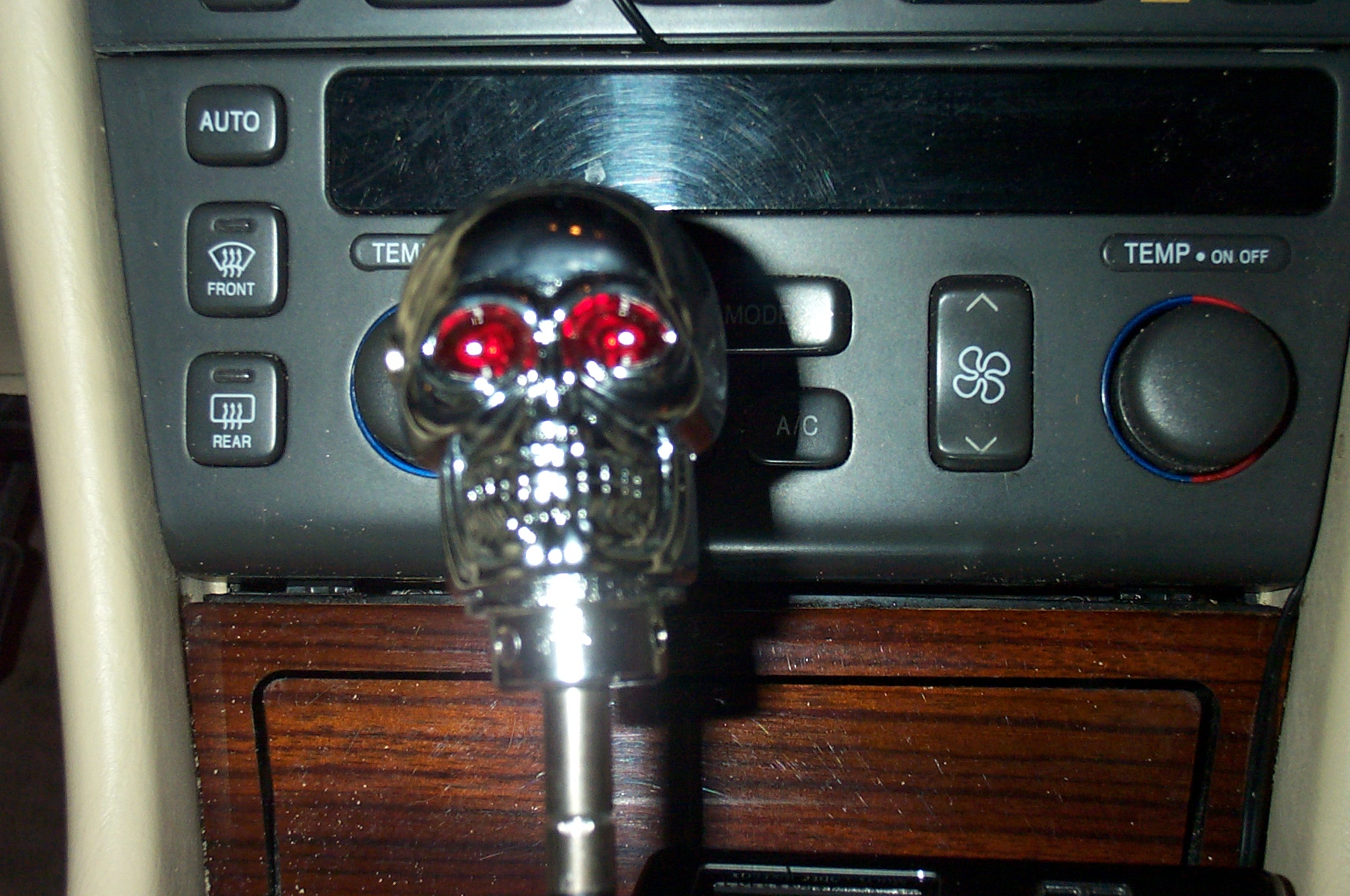

NSRG50
Posts: 730
Joined: Sat Feb 04, 2006 12:35 pm
Car: 1994 Infiniti Q45 & 1987 Chrysler Conquest TSi
sweet! cool work Wes! your Q sounds pretty wicked
http://www.q45.org/uploads2/Skullville/
You should get a skull shifter! It looked great in the Seville. Your Q is pure evil goodness now.
