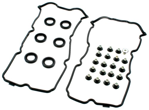

Yeah, those look just like the Nissan seals I found online! Great to hear. How easily did they pull out with the puller? Did you just press the new ones in by hand or did you use a different tool? When will you be installing them?

The set I got off eBay was from another 2001 QX4, and looked like this

Toyojay wrote:Do the VQ valve covers have gromments under each bolt that need to be replaced? (like a Jeep 4.0L if anybody has done one of those)
Some of the valve cover gasket kits I've seen out there include those grommets, so I'm guessing yes. That said, I don't see them on courtesyparts.com, so maybe not. They don't have the VC bolts either, though :squint: Maybe call a dealership and see what they say.

They don't have it listed, hmm. I just noticed under the part number for the VC I posted earlier, on courtesyparts they list that same number as fitting a 2000 model with the VG33... That can't be right.

Toyojay wrote: They don't have it listed, hmm. I just noticed under the part number for the VC I posted earlier, on courtesyparts they list that same number as fitting a 2000 model with the VG33... That can't be right.
...which is funny because Rock Auto says the gaskets also fit the VQ40DE (which wouldn't surprise me), not the VG33DE.
Where is the kit pictured available from?

Hawairish wrote: ...which is funny because Rock Auto says the gaskets also fit the VQ40DE (which wouldn't surprise me), not the VG33DE.

The picture I posted was for this Ishino set, who also sells this set. I think the only difference is production date compatibility (is there a difference??). I also found that Beck Arnley and Victor Reinz include them in their sets as well.
These gaskets fit a lot of vehicles, including some Suzuki. Check out the compatibility tab here. I'm shocked it fits the 4.0 too!

Since RockAuto only lists grommets for 01-02 models, which presumably only had aluminum valve covers, the plastic covers must not use them...which explains why I don't see them listed for my 04 model.

Yeah, I'm playing with the idea of getting new plastic ones from the dealer and installing those instead (they go for ~$180 on courtesyparts.com). The perks being that I would know the valve guides are installed right and the baffles will be clean as a whistle (and may employ an improved design)!
Some pictures of the Beck/Arnley covers:
One thing that has me concerned is it looks like the #1 spark plug looks to have a higher offset on the aluminum set, whereas it's the same height (flush) as the others on the plastic. If that's the case they're not going to be interchangeable without some modification.
Another pointer I picked up in my perusing is to apply some oil to the tubes and seals before you try to press the covers on. Doing so dry may tear up the seal.

I have aluminum installed now so the potential height difference on spark 1 on the plastic may not work. My trepidation about the set in use and the set I bought is I don't know if the baffles are blocked, but maybe I'm just overthinking this.
