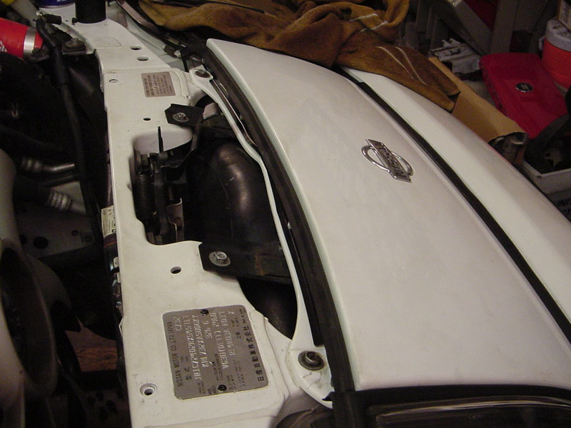

I see the two (obvious) screws at the top back of the nose panel, but there must be 2 more at the front corners. How do I get to them?

The only bolts visible are the four you need removed. The black brackets are part of the nose panel too.

Got it, thanks. Finally figured out that the bracket sits on pins at the front and is bolted down with those two bolts at the back. Plus the two obvious ones through the panel. You guys have made me smarter already. Thanks

Mine only has the outside two....weird.

Earlier models only had two, so it's normal.
