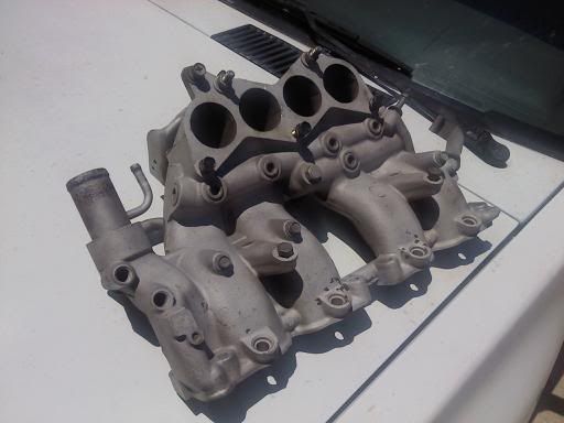

heres a pic of the mani all torn apart i know it doesnt look like much but it will get there
and i installed the cam today, and so far so good :woot:
it seems to rev faster and have a little more torque, cant wait to install the intake mani =]
ill update as i go enjoy

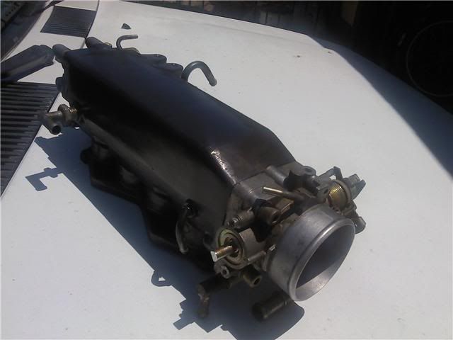

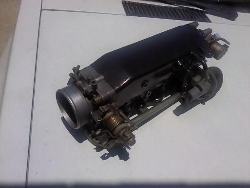

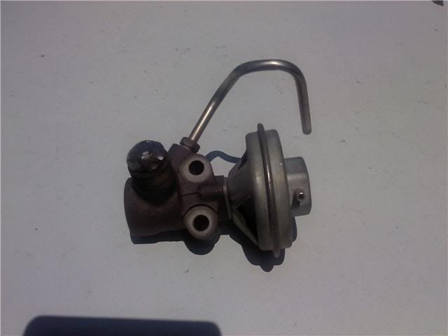

ok heres some pics of what ive been doing
smooth and pretty
sand blasted
blocked off egr to pass visual

thanks man i snad blasted what i could and degreased and wire brushed everything else.
so i painted and assembled a majority of it today cant wait to put this puppy on, just need injector orings, and a manifold gasket.
