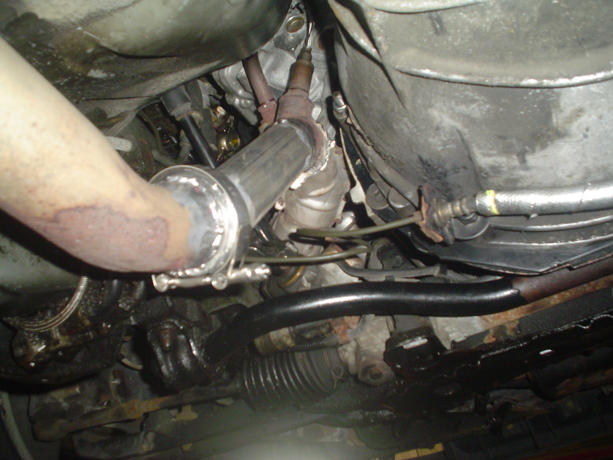

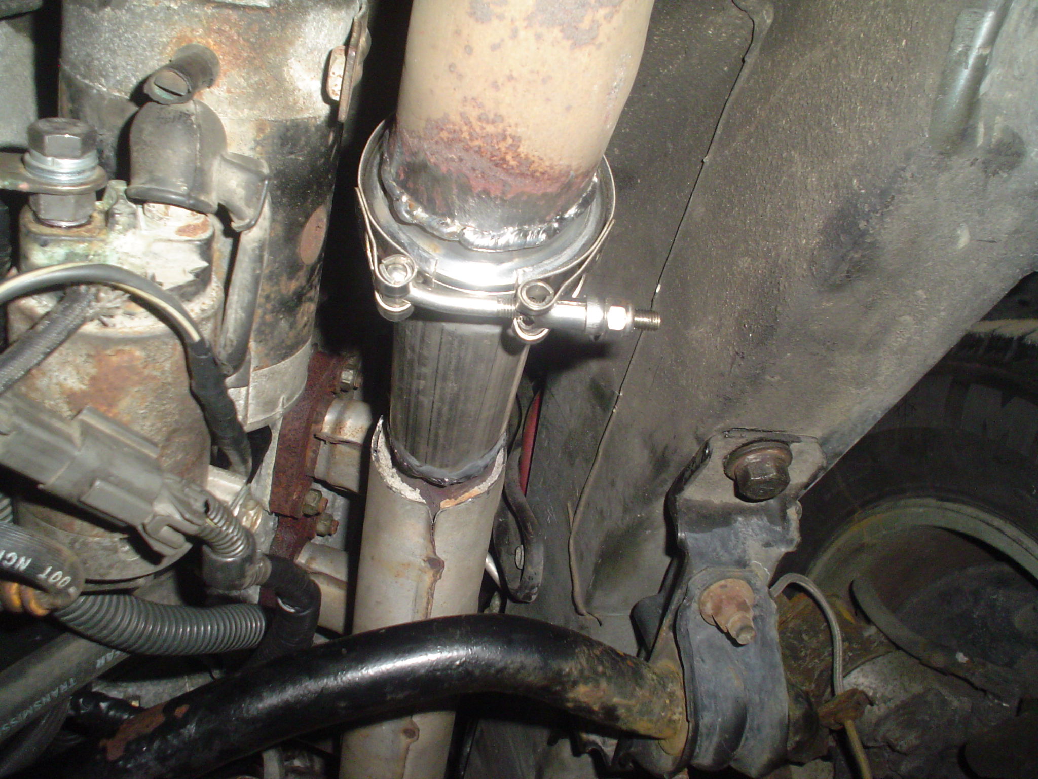

The major issue is clearing the starter on the passenger side, since the starter is now on the transmission versus the engine.
There's not much space between the starter and the exhaust...
Here's the drivers side

elwesso wrote:The major issue is clearing the starter on the passenger side, since the starter is now on the transmission versus the engine.
Dam that is pretty tight but I've built around worse, I just need to see measurements from the frame rail to the starter from both ends of it if the measurements are not equal and length of the starter. I might have to make the headers longer if I cant fit the collector in there. + I have to account for the engine mounts movement, which I don't think is much correct?

I think from the frame rail I have about 2" (probably 3 fingers, maybe a little more), and around the starter I probably have about 1/2" or less (about 1 finger)
