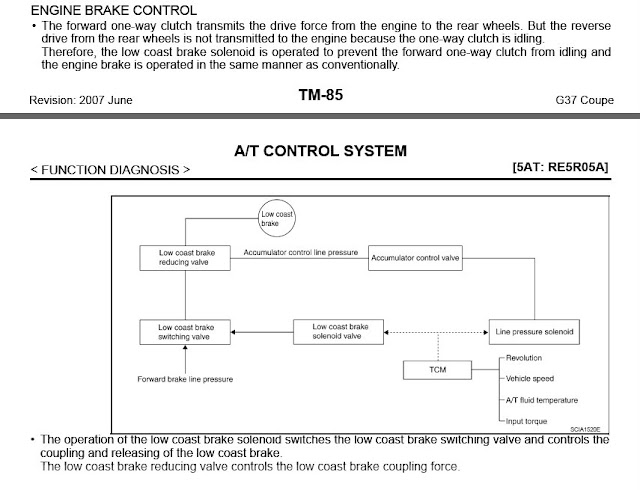

Welcome mkt and TommyC3, congrats on the G37s. It's a great car from the limited experiences I have had driving them. It would be one of the best ways to drive to work in the morning.
Ok I think I have an idea of what you are experiencing here but it makes perfect sense. On Monday I will look into this a little more to see if there is a reprogram that addresses this.
If you let off the gas while cruising the TCM will alter the gear range to try to better assist you when you need to accelerate again. While the car is dropping gears and speed is decreasing (at whatever pace it may be) at some point the (I do not have access to the 09 service manual ATM) the Overrun Clutch Engages, providing what is typically referred to as "Engine Braking" as the car normally upshifts through third gear (known example) Engine Braking will be felt. I am not 100% clear on the upshift logic of the RE7 but I will look into this when I get back to work.
It is basic shift logic principals using an overrun clutch and I do not know if that will be something that can be adjusted. Infiniti tried to remove the hunting feeling common in other 7+ speed transmissions.

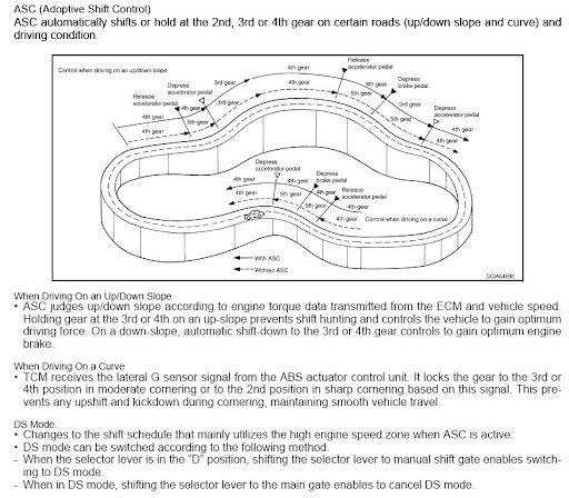

audtatious wrote:The only "issue" I have had with the transmission is when manually shifting. Downshift from 3-2 for a right-hand turn, turn at 20-ish, downshift to 1st and it stays in-between gears for about 3-5 seconds which is annoying.....RPM's are well within range and it should simply kick it down.
Huh check this out. It is supposed to hold the shift.
The operation is different on this model in comparison to older more traditional hydraulically controlled automatic transmissions. The additional electronic solenoids allow the TCM to more precisely control shift points, engine braking and advanced lock up duty cycle control. Allot of these types of things are not going anywhere and are going to be attributes of more modern transmission. Even compared to your Maxima the G uses a very different setup. The Max only had 4 linear solenoids (I think) and rudimentary oversight.

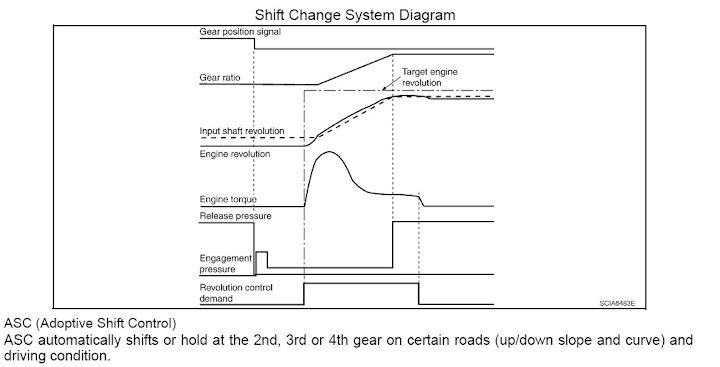

Thanks Mkt for the update. I'll have to ask the dealer if they have that update for the sedan.
Steve the tech, thanks for sharing the diagram. There's some good info there.
