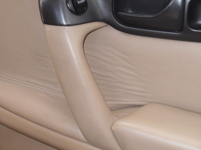

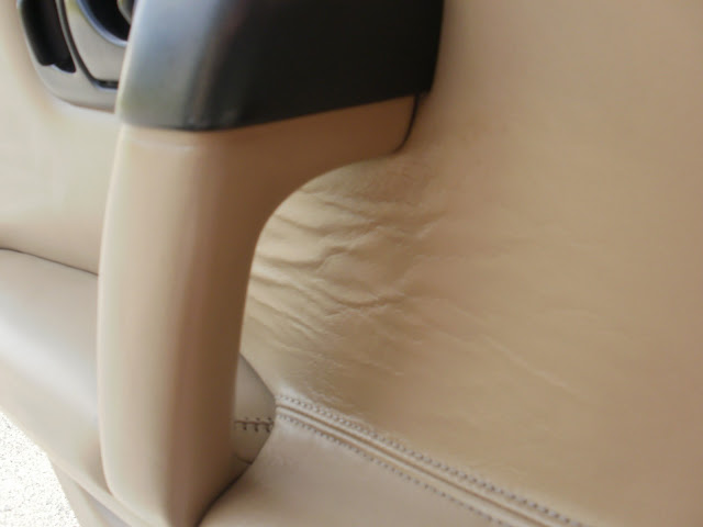

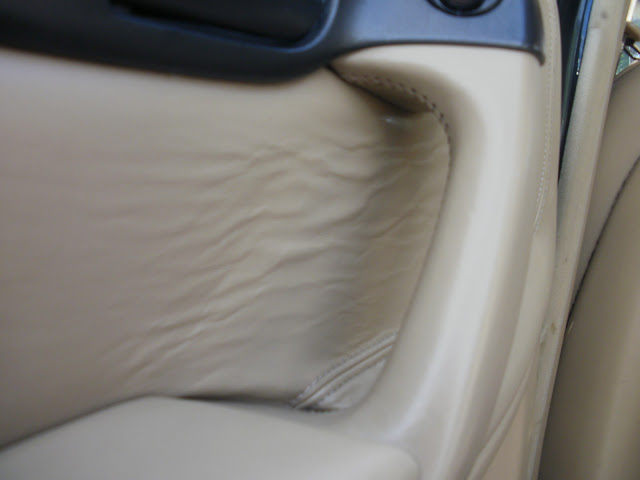

I have a problem with the wrinkled leather in my car. I have tried using some water on a sponge, soapy water and a sponge and Lexol PH cleaner and the Conditioner and today Lexol Neats Foot. None of the above have yielded a desirable effect, but has helped a tiny barely noticeable bit.
The padding behind the leather is nearly gone so do you think that replacing the padding with the above chemicals will fix this?
So what are my options besides Leatherique because I don't have the time for it?

Nothing will fix that, dont waste your money.

Well, if you're gonna scrap the panels anyway, maybe try some shallow (T30 or smaller) staples in as innocuous place as possible to hold the leather after you stretch it tight again? You could get some model paint from a hobby shop to touch-up the staples to the leather color... :gotme

Honestly I would try to ignore it, or take it to a good upholstry shop. I suspect leatherique won't do anything for it even if you had the time.

Forget about Leatherique Paul. I guarantee you you will not be inpressed nor will you achieve what you're after. You'll waste your time and money. Keep your eyes open for a pair of excellent condition door panels (no rush obviously).

try getting the leather moist and let stand in the sun. or use hot air gun. maybe the leather will shrink when moisture is pulled out of the leather. it does normally by being wet then drying it. just not sure if it has lost all of its collagen or whatever makes it stick together. if any change you will also have to deal with the glue on the back maybe have to be added

You could go to the backside of the door panel, pull up all the glued leather tabs and re-stretch and re-glue to get the wrinkles out. I have a feeling it wouldn't end up any better than what you've got now.
From looking at pics of newer Q's it seems like the leather "wrinkling" is a lot more common. Is there more padding in the newer Q's?

"rejuvinator oil" and all other "conditioners" are a total waste of time and effort when applied to a finished, COATED leather like the Q has.......even simple tap water will not penetrate or soak in..........only thing you can do is keep clean and apply a UV protectant on surface.....try 303 aerospace protectant, Vinylex, etc.....nothing gets past the plastic coating to absorb into the leather beneath.

He's got it. It's not leather you're dealing with. It's leather with a protective coating that you'll never get off, or through. Replace the leather or find somewhere else to spend your money.
