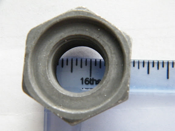

The manifolds have threaded ports for the sensors, but there is a spacer between those threads and the sensor. This works out nicely if you strip out the threads for the sensor, because you just unscrew the spacer and replace it instead of the whole manifold... Can you tell if they removed the spacer and plugged the entire hole, or just plugged the hole in the spacer? The spacer has hex edges on it so that you can twist it out with a wrench or socket.

Here are some pictures of the spacer that I'm assuming was welded shut on your car...

You are a star. Thanks for the trouble you have taken with the photos, very helpful. I will certainly try to replace the "modified" spacers. The space available to unscrew them is pretty limited though....
